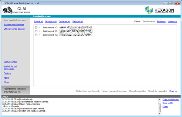

To return licenses for re-hosting:
Start the CLM Administrator (refer to the "Managing Licenses" chapter).
Make sure the computer is connected to the Internet.
Select View installed Licenses. The list of currently-activated entitlements appears.
Select the Entitlement ID to return.

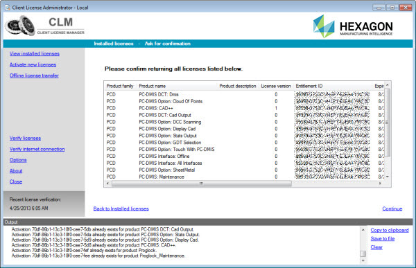

Select Return Licenses. The list of currently-selected licenses for return appears.
Select Continue to confirm returning the selected licenses.
A connection to the Hexagon Network License Server is established, and the selected licenses are returned.
