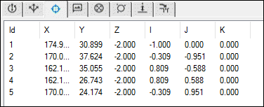

Probe Toolbox - Hit Targets tab
To view all the hits in the hits buffer, select the Hit Targets tab in the Probe Toolbox. PC-DMIS displays the XYZ and IJK data for each hit in the buffer. This read-only list changes dynamically as you take new hits or remove old hits from the hits buffer.
