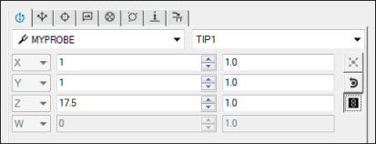

Position Probe tab
The Position Probe tab (View | Other Windows | Probe Toolbox) lets you switch between existing configured probes and probe tips, view the current probe's location, access the Probe Readouts window, and remove probing hits from the hits buffer.
