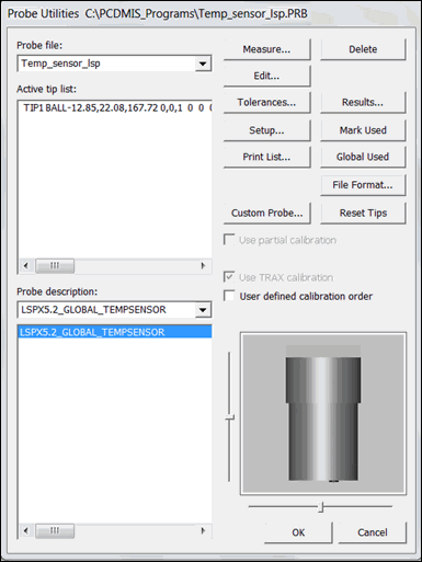

Open the Probe Utilities dialog box (Insert | Hardware Definition | Probe).
Build the temperature probe.
The description of the main probe body in the Probe Description area for a temperature sensor mounted on a probe head ends with "TEMPSENSOR".
LSPX5.2_GLOBAL_TEMPSENSOR
The graphic below shows an example of a temperature sensor mounted on a CMM probe head.
Example of Probe Utilities
dialog box for temperature sensor
mounted on CMM probe head
