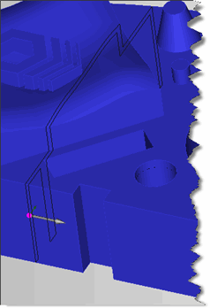

Once you define the cut plane, PC-DMIS draws a gray arrow that indicates the plane point and the direction of the cut plane normal vector. In addition, PC-DMIS draws a polyline (or one or more connected lines) on the CAD model. This represents the intersection of the plane (called the "cut plane") with the surfaces in the entire CAD model. Multiple section cuts are drawn as different-colored polylines to show when very small surface gaps are present. Since you haven't defined the start and end points yet, the red and magenta dots, which represent the start and end points respectively, initially appear on the CAD model at the plane point's location:
A sample plane point (indicated by the gray arrow) and cut plane (indicated by the black lines) drawn atop the CAD model
If the plane intersects the model in more than one location, PC-DMIS draws all the intersections.
