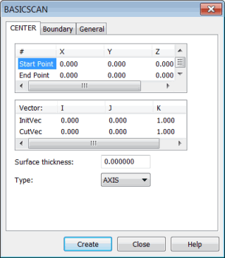

To find a Low/High point in an area, select Insert | Scan | Center. The CENTER tab in the BASICSCAN dialog box appears:
BASICSCAN dialog box - CENTER tab
This tab takes a start point of the scan and an end point and enables the controller to execute the scan. The output from this scan is a single point only.
For the center method, you do not need to set a boundary condition on the Boundary tab.
These parameters control the scan execution:
Start Point: This point is the start point from which the execution starts.
End Point: This point is the end point at which the execution ends.
You can directly type the points or obtain them from the machine or CAD.
