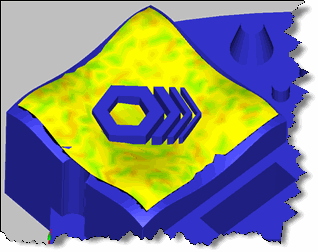

The different scanning approaches are useful in digitizing profiles on your part's surfaces.
Example of a surface plot of a patch scan
