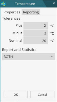

Use the Reporting tab to set tolerances and the type of report output.
Reporting tab - Temperature dialog box
Tolerances area:
Plus box - Type the plus tolerance. You can change the plus tolerance for each axes and/or part.
Minus box - Type the minus tolerance.
Nominal box - Type the nominal value. The default nominal temperature is 20°C.
The same nominal and tolerance values apply to scale and part temperatures.
If necessary, you can change the nominal temperature and tolerances for each axes and/or part in the Edit window.
Report and Statistics area - In the list, choose how to send the output of the command when it is executed:
STATS - Sends the output to a statistical file.
REPORT - Sends the output to an inspection report.
BOTH - Sends the output to both an inspection report and statistical files.
NONE - Does not send the output anywhere.
