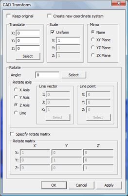

To transform your CAD model, open the CAD Transform dialog box (Operation | Graphic Display Window | Transform). Use the items in the dialog box as needed, and then click OK or Apply.
Performing a CAD transform operation does not transform any existing learned features. This operation essentially renders them useless. You may want to perform a File | Save As operation to create a backup of your measurement routine and CAD model before you proceed.
Keep original - This check box lets you keep a copy of the original, unmodified CAD model.
Create new coordinate system - This check box lets you create a new coordinate system from the newly-translated CAD model. For more information, see "Working with CAD Coordinate Systems".
Translate - This area defines the XYZ offsets to translate the model. You can type the specific location to which you want PC-DMIS to move the coordinate system. If you do not know the coordinates, you can use the Select button to select a specific CAD entity to which the coordinate system moves. See "Transforming by Selecting" below.
Scale - This area defines how the CAD model is scaled. This can be useful for fixing models that are not scaled correctly due to improper measurement-unit identification. For example, if the model is sized for millimeter units but you want it scaled for inch units, you can scale the model by 25.4.
The Uniform check box uniformly scales the model. If you want to scale a selected axis of the model, clear the Uniform check box. Leave the value as 1 for axes that you do not want scaled, and change the axis that you want scaled. You can also scale axes by negative values. This is useful if you want to mirror an axis. In this case, enter -1 for that axis.
Mirror - In this section, you can mirror the CAD view of a part. Mirroring provides the same functionality as using Scale with -1 specified for the mirroring axis. Mirroring your CAD model is particularly useful when measuring automotive parts that have identical left- and right-hand pieces. If CAD information is available for the right side of a part, you can mirror the appropriate axis, and create a CAD view of the left side of the part.

Rotate - This area controls how the CAD model is rotated. Type the angle you want to rotate the model by in the Angle box. You can type the specific location to which you want PC-DMIS to move the coordinate system. If you do not know the coordinates, you can use the Select button to select a specific CAD entity to which the coordinate system moves. See "Transforming by Selecting" below.
Rotate axis - This area defines
the line about which the CAD model is rotated. The model rotates about
this line by the specified angle. The direction of rotation follows the
right-hand rule.
You can use one of the coordinate-system axes as the line to rotate about
by selecting the appropriate X, Y,
or Z axis option button. If you do not want
to rotate about one of the coordinate system axes, you can rotate about
an arbitrary line by selecting the Line option
button. This enables the Line vector and Line point areas. Fill these areas out to determine
the point and vector that comprise the arbitrary line.
Rotate matrix - As you determine your CAD model's new transformation, this area automatically gets filled out with the values to use in a 3 X 3 matrix. This 3 X 3 matrix rotates the CAD model. Usually, you won't need to fill out anything in this area as it is generally for informational purposes only.
