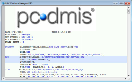

Edit window in Command mode
PC-DMIS uses different background colors, command text colors, and text characters to offset information in Command and DMIS modes. This coloring and text formatting may seem somewhat confusing at first, especially if you are used to previous versions of PC-DMIS and are suddenly barraged with a myriad of colors. However, rest easy; if you don't like them, you can easily revert PC-DMIS to its coloring scheme used in previous versions. For information on how to do this, see "Defining Edit Window Colors" in the "Setting Your Preferences" chapter.

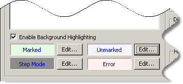

Different background colors help you know what commands are marked, unmarked, have errors, are active, or are being stepped through. You can find the definitions for these background colors in the Color Editor dialog box (Edit | Preferences | Edit Window Colors) for the Edit window.
Edit window background color information in the Edit window's Color Editor

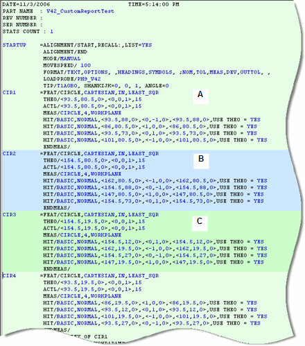

Consider this example screen shot:
Edit window example showing the coloring scheme
A - A light-green background means the command has been marked for execution.
B - The light-blue background means the command has not yet been marked for execution.
C - A slightly darker background color (either darker green for marked commands or darker blue for unmarked commands) shows the current active command.

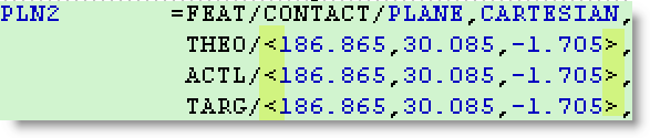

"<" and ">" Characters Provide Enhanced Readability
The "<" and ">" characters group like values together, thereby more easily delineating the different fields for various X, Y, Z and I, J, K values. These characters show where these pairs begin and end. This enhances readability and makes it much easier to locate needed values.
