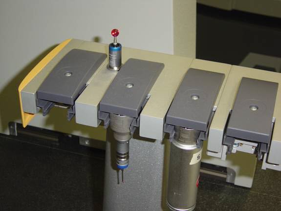

This documentation expects that you are positioning the probe changer so that the center post of the probe changer is vertical to the CMM table with the ports parallel to the CMM table:
TESASTAR-R / HR-R Probe Changer
The TESASTAR-R / HR-R Probe Changer MUST be mounted on the machine table parallel to a machine axis, such as the X or Y axis. For mounting instructions, consult the documentation that came with your probe changer.

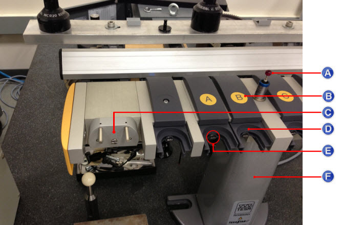

Probe Changer Components
TESASTAR-R / HR-R Probe Changer components
TESASTAR-R / HR-R Probe Changer components:
A - Datum Sphere
B - Lid/Cover
C - HD Port
D - Port
E - Key
F - Center Post

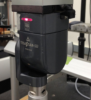

Wrist Types
The procedure for calibrating the TESASTAR-R / HR-R Probe Changer varies depending on the type of wrist. This documentation defines the wrists as follows:

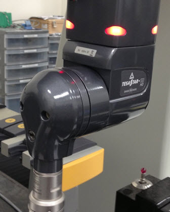

HD wrist with an HDKJ extension:
Wrist
