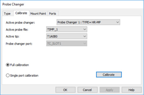

To start the calibration process, do the following:
  1. Select the Calibrate tab in the Probe Changer dialog box (Edit | Preferences | Probe Changer).
  2. In the Active probe changer list, select Probe Changer 1: TYPE=HR-MP:
Probe Changer dialog box - Calibrate tab
  1. The entry in the Active probe file list defaults to the current measurement routine setting. If this is not what is to be used for the rack calibration, select the proper probe.
  2. The entry in the Active tip list defaults to the current measurement routine setting. If this is not what is to be used for the rack calibration, select the tip ID to be used for calibration. This is usually T1A0B0.
  3. Click Calibrate. The following message box appears:
