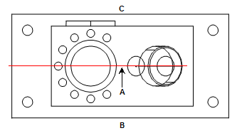

A - Constructed line (a mid
line) equally spaced between two lines (FRONT and BACK)
B - FRONT
C - BACK
Constructing a mid line from two lines
