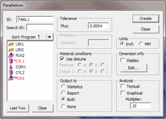

ID Feature Search ID Feature List box Last button Clear button Plus Tolerance for Parallelism Projected Distance Material Conditions area Output To area Create button Close button Units area Display check box Edit button Analysis area
Dimension Parallelism dialog box
The Insert | Dimension | Parallelism menu option measures the parallelism between two features. The second feature is always the datum feature. When only one feature is selected, the current workplane becomes the datum feature. This dimension type is considered one sided, meaning a single positive value tolerance is applied.
The evaluation of parallelism is 3-dimensional regardless of the workplane or the feature being dimensioned.
