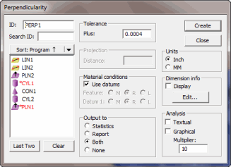

ID Feature Search ID Feature List box Last button Clear button Plus Tolerance for Perpendicularity Projected Distance Material Conditions area Output To area Create button Close button Units area Display check box Edit button Analysis area
Dimension Perpendicularity dialog box
The Insert | Dimension | Perpendicularity menu option measures the perpendicularity between two features. The second feature is always the datum feature. When only one feature is selected, the current workplane becomes the datum feature. This dimension type is considered one sided, meaning a single positive value tolerance is applied.
