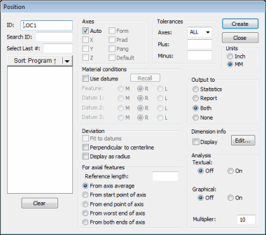

Dimension Position dialog box
The Insert | Dimension | Position menu option calculates the position from the feature to the X, Y, or Z origin parallel to its respective axis. The feature's diameter, angle, and vector are also part of the calculation.
The Position dialog shown above is available only when the Use Legacy Dimension option is selected from the Insert | Dimension menu.
