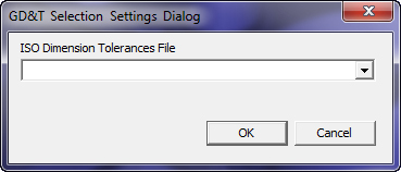

For PC-DMIS or PC-DMIS Planner, to use a tolerance CSV file, you need to select that CSV file from the GD&T Selection Settings Dialog dialog box. Use the ISO Dimensions Tolerance File combination box from the GD&T Selection Settings Dialog dialog box to choose the CSV file that you wish to use as shown below.
To open this dialog box, select Edit | Preferences | CAD GD&T Selection in PC-DMIS, or Edit | Setup | GD&T Selection in Planner.
