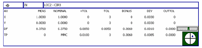

Example of Position "Use Datums" Off:

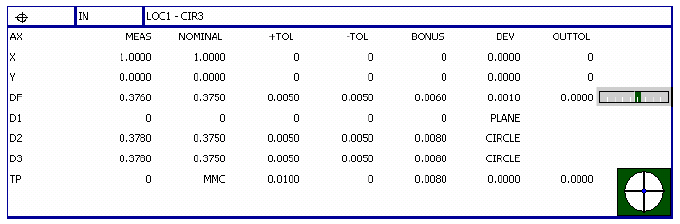

Condition #1A: In-Tolerance
When sufficient bonus tolerance from the datum(s) allows datum shift such that there is no deviation from the nominal values without utilizing up to 100% of the allowable bonus from the datum(s), the total bonus amount is the sum of the bonus from the feature and the unused amount of bonus from the datum(s).
Example of Condition #1A In-Tolerance:
The measured values changed based on the allowable datum shift derived from the bonus of datums D2 and D3 (simulates a functional gage). In this case the measured values check nominal resulting in zero deviation, and the total bonus is the sum of the bonus from the feature (0.006) and the unused bonus from the datums (0.002) for a total of 0.008 bonus tolerance.
Two degrees of freedom from bonus on D2 (0.008 bonus): translation in X and Y axis
One degree of freedom from bonus on D3 (0.008 bonus): rotation about Z axis

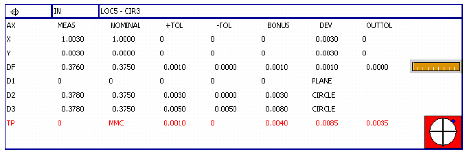

Condition #1B: In-Tolerance
When 100% of the bonus from the datum(s) is used then the total bonus amount is only the bonus from the feature. Typically this case would show some amount of deviation from the nominal values.
Example of Condition #1B In-Tolerance:
The tolerance for D2 and D3 were changed to illustrate using 100% of the bonus from the datums where there is deviation from nominal yet still an In-Tolerance condition.

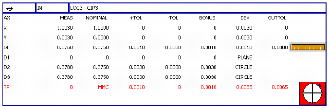

Condition #2: Out of Tolerance
When there is insufficient bonus from the datum(s) to allow datum shift such that the feature is In-Tolerance, no fitting is performed, the measured values are not altered and the total bonus is only the bonus from the feature.
Example of Condition #2 Out of Tolerance:
The tolerance for the DF, D2, D3 and the TP were changed to illustrate the out of tolerance condition.

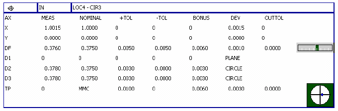

Example of Condition #1 In-Tolerance:

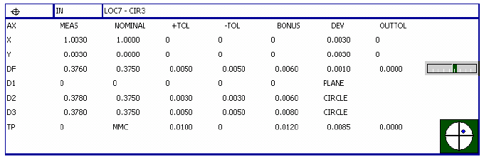

The tolerance for the DF, D2, D3, and TP were changed to illustrate the out of tolerance condition.
