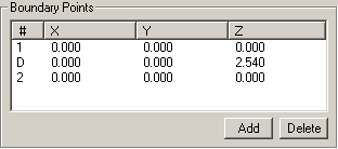

To define the boundary of a scan in the scan dialog box (Insert | Scan), PC-DMIS allows you to key in or measure points, or use CAD data.
A sample Boundary Points area
This function is only available for DCC scans.

ROTARY - These scans require you to have at least a start point and a direction point (shown as 1 and D respectively in the Boundary Points list and on the CAD display).
If you don't have an end point (shown as 2), PC-DMIS continues to measure the scan along the specified direction until it returns to the start point.
If you have a start point and an end point, PC-DMIS scans along the specified direction until it reaches the end point.
PC-DMIS defaults to providing you with a start, direction, and end point in the Boundary Points area. You can delete the end point, but you cannot delete the start or direction point.
As you define each boundary point (by either clicking on the CAD or typing in the values), PC-DMIS automatically snaps each point to the radius distance from the center point unless you didn't define a radius. In this case, the first boundary point you define also defines the radius.
