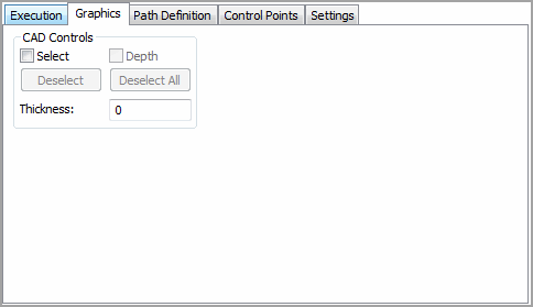

Graphics tab from a scan dialog box
The Graphics tab in the scan dialog box (Insert | Scan) lets you use the on-screen CAD model to aid in creating a scan. This tab contains the CAD Controls area. This area lets you specify the CAD surface/wireframe elements that will be used to find nominals as well as the part's thickness.

Select check box
Selecting this check box and clicking on surfaces lets you define the exact surfaces to scan. Manually determining the surfaces to scan helps speed up the FINDNOMS process. Once a CAD surface is selected, it is highlighted in the Graphic Display window. The Status bar displays the number of surfaces that have been selected. If the Select check box isn't selected, PC-DMIS assumes any clicks on the surface to be Boundary Points.

Depth
check box
This check box is used only when selecting Curve elements. You can indicate
a particular CAD curve element as a Depth element.

Thickness box
The Thickness box allows you to input the part thickness. Positive or negative values can be used. This amount is primarily used for thin parts (plastic or sheet metal) where the CAD data only describes one side. Often with thin parts, the CAD engineer will only draw one side of the part, and then specify the material thickness. PC-DMIS will apply this material thickness automatically when using the CAD surface data.
This thickness is applied along the surface normal vector when FINDNOMS mode is selected and PC-DMIS pierces the CAD surfaces to get the nominals, even when using Edge hits.
