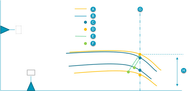

THCKG1_DP1 (Drop Point Primary) - This is the pierce nominal and actual primary curve at the Gage Distance.
THCKG1_DS1 (Drop Point Secondary) - This is the pierce nominal and actual secondary curve at the Gage Distance.
THCKG1_THP1 (Thickness Point of THCKG1_DP1) - This is a duplicate point of THCKG1_DP1.
THCKG1_THS1 (Thickness Point Secondary) - This is the pierce nominal and actual secondary curve normal to THCKG1_THP1.
To report the thickness and gage position, the Thickness Gage command uses a Gage Axis method:

A - Actual
B - Nominal
C - Nominal Drop Point XYZIJK
D - Actual Drop Point XYZIJK
E - Normal to Top Curve
F - Thickness Point XYZIJK
G - Gage Distance
H - Drop
You can determine which dimensions to report with the Primary Drop, Secondary Drop and Thickness check boxes.

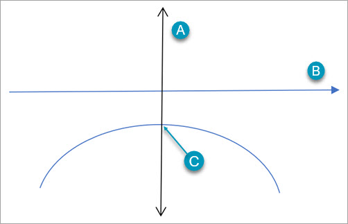

You must use simple curves to create a POI. A simple curve is a curve that has only one intersection along any line normal to the gage axis.
A - Vector normal to the gage axis
B - Gage Axis
C - Single intersection point along the line normal to the gage axis
Example of a simple curve

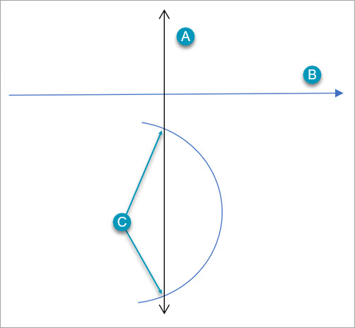

C - Multiple intersection points along the line normal to the gage axis
Example of a non-simple curve
When you manually enter the gage distance value or click the CAD to create a POI, if the primary or secondary curve is not simple, PC-DMIS displays an error message and does not create a POI.
