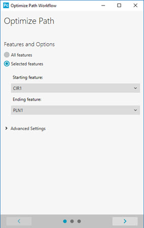

Optimize Path Workflow dialog box (Panel 1)
On panel 1, from the Features and Options area, decide to optimize the path for all the features (All features) or a subset range of features (Selected features).
If you choose Selected features, from the Starting feature list, choose a start feature. You can also choose the feature directly from the Graphic Display window.
If you choose Selected features, from the Ending feature list, choose an end feature. You can also choose the feature directly from the Graphic Display window.
You can also open the dialog box with the starting and ending features already selected if you choose them first from the Edit window.

If you need to do so, modify items under Advanced Settings.
Click the next button (
) to move to panel
2 in the dialog box. This initiates the path optimization process
and shows a progress bar.
The path optimization makes permanent changes to your measurement routine. Make sure you're satisfied with the options in the first panel before you start the process on panel 2.
Once the optimization process finishes, the only way to revert it is to choose File | Quit and close the modified routine without saving it.
The previous button (
) only
remains active until the optimization process finishes. Once the process
finishes, you cannot go back to the first panel.
