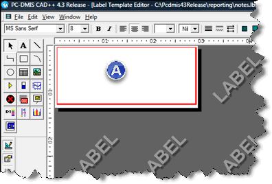

To create a note box, create a new label template inside the Label Template Editor, and drag a Text object onto the editing area. Format the object with font size, font color, background color and borders as desired. If you want your note box to be transparent, select the NIL background color. Set the object's Text property to hold this value: "Right-click here and select Edit Object to modify this note text." Save your label template.
A new label template named notes.lbl
(A) - Right-click here and select Edit Object to modify this note text.

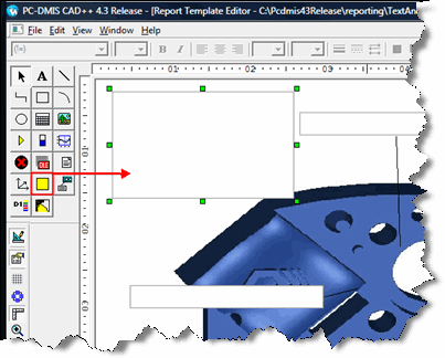

Open up a report template inside the Report Template Editor that you can edit. Drag a Label object onto the editing area, and position it more or less where you want the note box to appear. You can change its final position in the Report window.
A label object added onto a TextAndCad Report

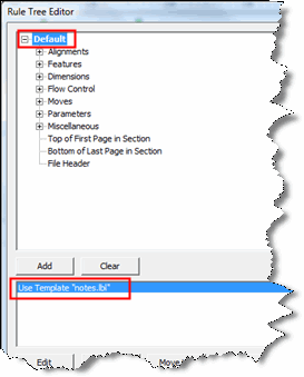

Right-click on the label object to access the Properties dialog box, and then click Rules to bring up the Rules Tree Editor. The new label object does not yet have any rules. Add a rule for the Default item at the top of the tree, and have the rule pull in the label template you saved in Step 1. This action causes the label template containing your note box to show up on every page of the report. Save your changes.
A rule specifying to load notes.lbl assigned to the Default item

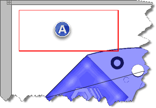

Access the Report window and load in your modified report template. Notice that your note box appears with the instructions on how to change its default text. Double-click to activate the object and drag it to a new location if desired.
A note box with default text

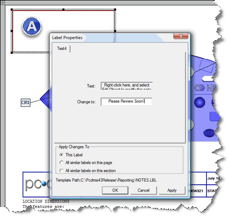

To change the text in the note box, right-click the object and select Edit Object. A Label Properties dialog box appears.
The Label Properties dialog box
Type your new note text in the Change to: box and click OK. PC-DMIS updates your text.
A note box with updated text
(A) - Please Review Soon
