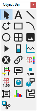

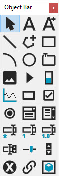

The Object Bar is a toolbar that lets you insert various objects into a template or objects and controls into a form. You can insert text, pictures, multi-media, dialog box controls, special PC-DMIS specific objects, and other items to help you create custom labels, reports, and forms.
This bar appears whenever you enter an editing environment such as the Report Template Editor, the Label Template Editor, the Custom Report Editor, or the Form Editor.
The Object Bar comes in one of these types, one for each editing environment:
Report Template Editor |
Label Template Editor |
Custom Report Editor |
Form Editor |
Click on object icons in an Object Bar above to view information about that object. |
