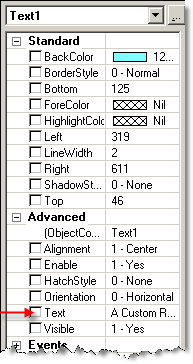

Select the Text object you created in the previous step.
Right-click on the object.
This causes the Properties dialog box
for that object to appear on the right side of the editor. On
the left side of the dialog box you will see
check
boxes next to most properties. These check
boxes determine what properties you can make user definable.
Sample Property Sheet for a Text object. Notice the user definable check boxes on the left.

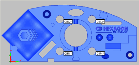

Add the CADReportObject on the template by dragging a box on your template's section. Size the box so that it measures about 6 inches wide and 4 inches tall. You can size the object by clicking and dragging one of the green boxes surrounding the object.
When you finish drawing the box, PC-DMIS automatically displays the Label Layout Wizard. This wizard shows a fake part surrounded by some fake labels. These dummy items are simply design aids while working in the template editor. You can use this wizard to set up labels around your part. For in-depth information, see the "The Label Layout Wizard" topic. When you apply this template to your report, PC-DMIS uses your actual CAD drawing and label information.
Change the Label Count box number of labels to 4.
Change the Layout Style to Elliptical Packed.
Click on the small, square, white handle in the middle of the CAD drawing, and drag the square clockwise or counterclockwise to rotate the labels along the elliptical path.
Rotate the labels until
all four are above the CAD drawing and the Layout
Preview area of the Label Layout Wizard
looks
like
this:
Layout Preview area showing four labels elliptically packed above the CAD drawing
Click OK. PC-DMIS inserts the object into Section2.
Your Section2 layout
should now contain a CADReportObject
looking something
like
this:
Example CAD report object showing the four dummy labels above the dummy part

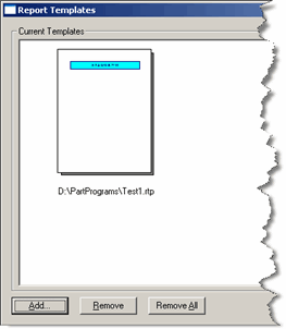

Add your report to the Report Templates dialog box by clicking the Add button.
Navigate to and select
test1.rtp. Then click Open. PC-DMIS
adds a thumbnail view of your report into the Report
Templates
dialog
box.
Report Templates dialog box showing Test1.rtp

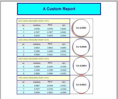

Select your template's
thumbnail icon, and click Open. PC-DMIS
opens the Report window using your newly created template. It
should look something
like
this:
Report Window Showing Report Data Using the Test1.rtp Report Template
Finally, execute your measurement routine. The first time you execute the measurement routine using this report template, PC-DMIS will display a Define User Assigned Properties dialog box, asking you to give the report a new title and to set the background color.
Set these properties as desired, and click OK. The dialog box closes and PC-DMIS runs your measurement routine.
When execution finishes, PC-DMIS shows the report data with the new template.
Congratulations! You have finished the Custom Report Template tutorial.
