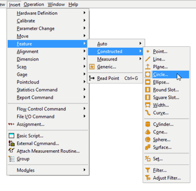

Menu
Items - Hover your pointer over a menu item (not
over a menu heading) on the menu bar. Press F1. PC-DMIS
displays the Help topic associated with that menu option.
