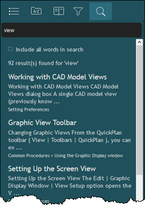

Search tab of Help file
You might first look for information using the Index tab on the Navigation pane. However, that may not yield the desired topic. Because indexes are created based on defined keywords, you may be thinking a topic should be using a different keyword than it actually does. If you cannot find what you're looking for in the Index tab, use the Search tab.
With the Search tab, you can search within titles and topic text for a specific word or phrase.
To use the Search tab:
  1. From within your software, select Help | Index to access the Help system in your browser.
  2. If the Search tab is not already displayed, from the toolbar, click the Expand () to display the Navigation pane.
  3. Click the Search tab and type what you want to search for in the -Search- box. If you place the text in quotation marks, the Help system attempts to find that exact phrase. Otherwise, by default, the Help system tries to find topics with all the search terms in any order. To find even more topics, you can clear the Display results with all search words check box under the -Search- box to show results with partial matches.
  4. From the list of possible matches that appear, click a topic from the list to view it in the Topics Pane. The Help system highlights all the terms that match your typed selection. You can scroll down the list of topics to load more topics that the search found.
