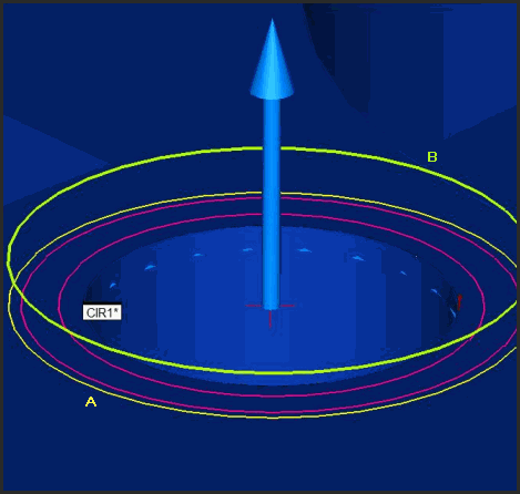

The clipping distances defined in the feature based clipping rings are shown as colored rings. The horizontal clipping appears as a yellow ring, and the vertical clipping appears as a light green ring.
Sample Circle auto feature with horizontal clipping (A) and vertical clipping ring (B)

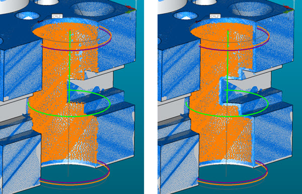

The CAD offset check box is available for all 3D Auto features (Plane, Cone, Cylinder and Sphere).
You can enable the CAD offset option for Plane, Cone, Cylinder and Sphere auto features. The CAD offset option provides a way for PC-DMIS to shrink away from the selected CAD face and eliminate points which are within the offset distance to the edges of the feature.
For Plane auto features, when you select this check box, PC-DMIS creates a yellow offset boundary around each feature in the CAD model on the surface. For a Cone, Cylinder or Sphere auto feature, PC-DMIS does not display this yellow offset boundary outline.
Example of a Plane auto feature with CAD-based clipping enabled
Example of a Cylinder auto feature with no CAD offset (left) and with 2mm CAD offset (right)
You must select a CAD face when using the CAD offset option.
PC-DMIS clips the laser data that falls inside of an offset boundary for all of the features in the CAD model on a surface. The data outside of the offset boundary is used to solve the plane.
