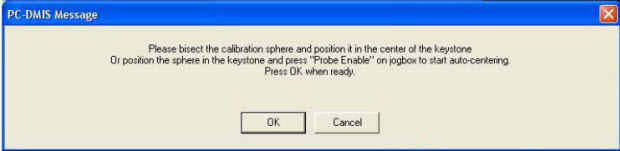

When you use either the MAN (Manual) or MAN + DCC Motion option, you will be required to manually bisect the qualification sphere. This is also necessary if you have moved the sphere or do not know the location of the sphere. The calibration procedure will prompt you when you need to move the machine.
PC-DMIS Message
To manually bisect the sphere:
Leave the PC-DMIS Message open.

Click OK in the PC-DMIS Message to accept the change you made of aligning the arc. PC-DMIS stays in Execute mode, and the laser sensor moves through a series of defined positions used to calibrate your tip.

The CMS laser sensor provides automatic self-centering (bisecting) of the calibration tool sphere during calibration if you answer Yes to the question, "Has the sphere moved?". From the Graphic Display window, click the Laser tab. You can drive the laser sensor to the center of the sphere.
You have two possibilities at this point:
You can manually bisecting the sphere and bring it in the center of the Keystone and then press OK to start the laser calibration.
Display a portion of the calibration sphere in the Laser View and then press the Probe Enable button to automatically center the sphere. When completed, press the OK button to complete the laser calibration.
The PC-DMIS Message dialog box appears as soon as PC-DMIS determines that the calibration sphere has been moved.
Follow the instructions as described in the message box.
Press the OK button when done.
