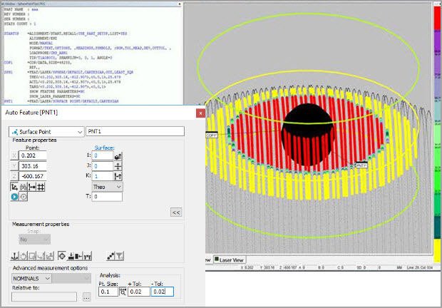

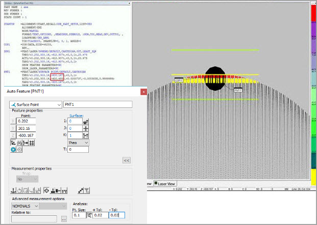

This method calculates the laser surface point by fitting a local plane on the scan points within the circular area defined by the horizontal and vertical clipping parameters; this is the default method. The following is an example and its details:
Planar Surface Point example
Planar surface point example - details
