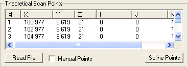

You can define the Theoretical Points of a scan through any of these actions:
Reading them from a file
Reading machine positions
Generating them from the defined boundary points
Using CAD data
These topics are discussed in greater detail later in this section.
Theoretical Scan Points area
