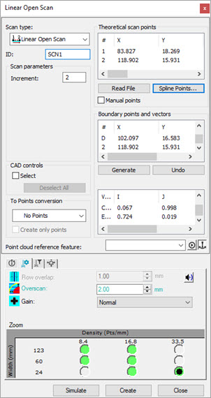

Open the Linear Open Scan dialog box (Insert | Scan | Linear Open).
In the Scan parameters section, set the Increment value.
At the bottom of the dialog box, click the Laser Scan Properties tab, and set these options:
Enter the Overscan value.
Select the Gain option from the list.
Select the stripe Width and scan Density setting.

Click the Simulate button to show the simulated pointcloud based on the current probe orientation (active tip) and laser scan settings.
