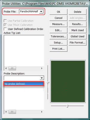

  1. From the Quick Start (View | Other Windows | Quick Start), click the Calibrate Probe button , or from the main menu, select Insert | Hardware Definition | Probe to open the Probe Utilities dialog box and create your probe file.
  2. Enter a name for your new probe in the Probe File list.
  3. Click the No probe defined in the Probe Description area to populate the list.

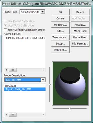

  1. Choose TRACKER from the Probe Description list.
  2. Click the Empty Connection #1 item to display more list options.
Choose SMR_12.7MM (1/2”), SMR 22.225MM (0.875”), or SMR_38.1MM (1-1/2”) for the standard Faro SMR.
  1. Click OK to save.
