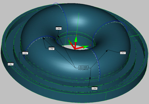

An example of measurement with the 2d Vector Calibration invoked is to measure profiles around the Toroid (pictured below) and also used for calibration.
Measurement of a Torus Feature

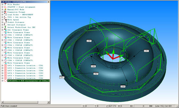

In this case, a separate measurement routine is created and the CAD model of the toroid is used.
PC-DMIS Measurement Routine and CAD Model for Torus

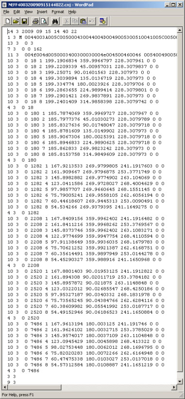

The Journal file produced is shown below.
Torus Journal File
