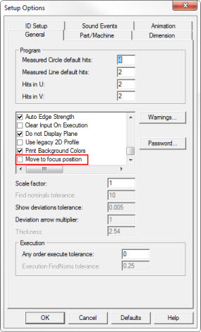

This value can also be set through the PC-DMIS Setup Options dialog box.
With PC-DMIS running, press the F5 key on your keyboard to display the Setup Options dialog box.
Setup Options dialog box showing the Move to focus position check box option
Select the General tab.
Navigate to the Move to focus position check box option in the center list box.
Select the Move to focus position check box option and click the OK button.
