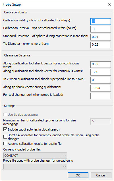

The Probe Setup dialog box provides an ability to set the limits for the above errors.
To open the Probe Setup dialog box, from the Probe Utilities dialog box (Insert | Hardware Definition | Probe), click the Setup button.
To set the "Calibration Validity" error, you can type the number of days in the Calibration Validity - tips not calibrated for (days) box. If you set this value to -1, the Check Calibration Limits command does not check for this error.
To set the "Calibration Interval" error, you can type the number of hours in the Calibration Interval - tips not calibrated within (hours) box. If you set this value to -1, the Check Calibration Limits command does not check for this error.
To set the "Standard Deviation" error, you can type the standard deviation value in the Standard Deviation - of sphere during calibration is more than box.
To set the "Tip Diameter" error, you can type the diameter value in the Tip Diameter - error is more than box.
