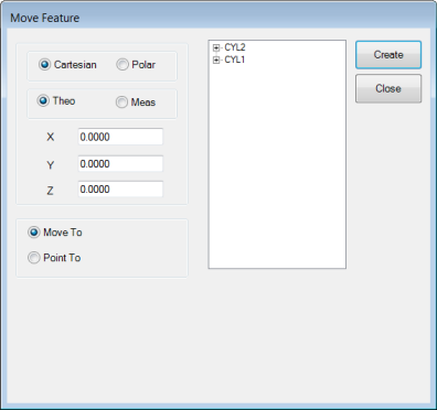

To create a Move Feature command, select the Insert | Modules | Move Feature menu option. The Move Feature dialog box appears:
Move To
The Move To option moves the device to a specific location where it then tries to find a reflector. This command is used only with Leica Total Station or Leica Tracker devices.
To move to a point, select the Move To option and then define where it should move to. There are three ways to specify the location to which it should move:
Method 1: Type the values into the X, Y, and Z boxes (or R, A, and Z if you selected the Polar option).
Method 2: Select the feature that you are going to move to from the Feature list. When you select the feature, PC-DMIS completes the X, Y, and Z values based on the centroid of the feature.
Method 3: Expand the feature by selecting the + symbol next to it to display the hits on the feature. While "hits" is something of a misnomer, it simply means the point measured by the laser device. Select one of the hits from the list. PC-DMIS completes the X, Y, and Z values for that hit.
You can choose to move to the measured value or the theoretical value for the point by choosing either the Meas or Theo option, respectively.
Once you have set up the command correctly, click the Create button to insert the command into the Edit window. Here is an example:
MVF1 =MOVE FEATURE/MOVE
TO,CARTESIAN,THEO,<-36.3574,33.3898,-10.8127>,
FILTER/NA,N WORST/1,
POINT TO METHOD/NA,DELAY IN SEC/0.0000,
REF/PNT1,

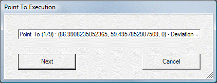

Next Move Button option - During execution, a Point To Execution dialog box appears and shows the index of the point in the list along with its location. For example:
This dialog box has the Next and Cancel buttons, which you can use to control when to point to the next hit in the list. The device moves to the first point, turns on the laser, and then waits until you click the Next button. It then moves to the next point in the list.
