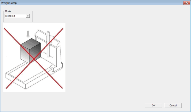

Use the Disabled mode to disable the Weight Compensation. You should place the command for disabling Weight Compensation at the end of the measurement routine in order to avoid undesired persistence of Weight Compensation among different measurement routines.
To use this mode:
  1. In the Mode list, click Disabled. The following dialog box appears:
WeightComp dialog box - Disabled mode
  1. Click OK.
