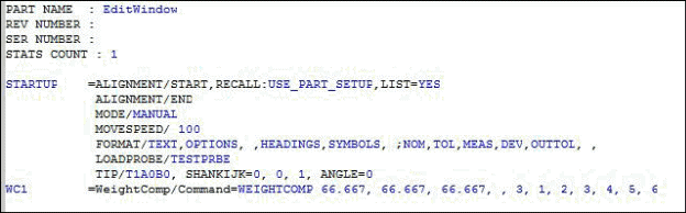

Here is an example of the Edit window for the Simplified mode:
Edit window for Simplified mode
Example of Edit window for Simplified mode
