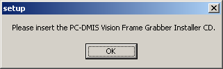

When your LMS license or portlock is programmed with the Vision option and no frame grabber software has been installed, you are prompted to install Frame Grabber software.
Click Yes to continue or No to skip Frame Grabber installation. You are prompted to insert the installer CD.
Once you have inserted the installer CD, or you would like to browse for the Installer executable (SetupFramegrabber.exe), click OK. After locating SetupFramegrabber.exe, run the program, select your frame grabber from the list, and follow the instructions to install the Frame Grabber software.
