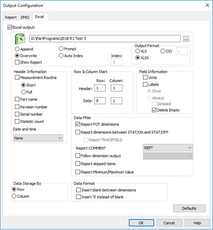

In the Output Configuration dialog box (File | Printing | Report Window Print Setup), the Excel tab outputs the report to an Excel file.
PC-DMIS follows the mode of the Report window:

To output a report in an Excel format:
Click the Excel tab on the Output Configuration dialog box (File | Printing | Report Window Print Setup).
Select the Excel output check box to enable the tab's options.
Make your selections in the dialog box as needed and then click OK.
PC-DMIS saves the inspection report's information in the Excel file format that is selected in the Output Format area. The default is the same base file name as your measurement routine with a .xlsx file extension. The default location is in the same directory as your measurement routine. The available Excel file format options are:
The latest Excel .xlsx format
The older Excel .xls format
The comma-separated value (.csv) format
Configuring the Excel Options
When the Excel output check box is selected, the following options become available:
