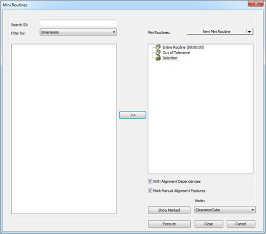

To use mini routines, select File | Partial Execution | Mini Routines. The Mini Routines dialog box appears. For example:
Example of Mini Routines dialog box
The Dimension (left-most) pane displays the items (features, dimensions, and groups) that are available in the measurement routine. The Mini Routine (right-most) pane displays the mini routines.
PC-DMIS automatically creates these mini routines:

  3. Select ClearanceCube or FBM in the Mode list. For descriptions, see "Modes".
  1. Click Execute. PC-DMIS closes the Mini Routines dialog box and displays the Execution dialog box.
