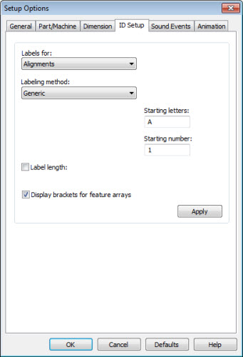

Click on any of the tabs along the top, or buttons along the bottom of the image below, to display information on their functionality.
Setup Options dialog box-ID Setup tab

The ID Setup tab allows you to alter the format used to identify alignments, dimensions, features, comments, labels, variables, and other items.
To access this option:
Access the Setup Options dialog box (Edit | Preferences | Setup).
Select the ID Setup tab.
The default Labeling method is Generic. As each feature is created, PC-DMIS assigns it an ID beginning with the letter F, followed by a number (incrementally set from the starting number of one). You may choose to override this setting by selecting options on this tab.

Options in the ID Setup Tab

Labeling Method - This drop-down window is used to select between By Type and Generic identification methods.
By Type
By Type lets you set the identification for each element type (for example:
circle, cone, cylinder, line, plane, point, sphere, and so on).
Generic
Generic will apply the same identification system
regardless of feature (dimension) type.
PC-DMIS has no inherent limit on the number of letters used for identifications. However, the Graphic Display area and Edit window have limits on the ID length. Even if the Edit window does not show the complete ID, PC-DMIS internally keeps track of the complete identification.
Starting Letters - This box determines the first letter(s) used in the identification process. PC-DMIS always displays the ID using capital letters.
In various dialog boxes where the ID is displayed, if you modify the ID there, PC-DMIS displays a prompt asking you if you would like to change the default ID for that item type.
Starting Number - The Starting Number box determines the first number used in the identification process. Any number between 1 and 9999 can be entered.
In various dialog boxes where the ID is displayed, if you modify only the number portion of an ID, the counter may be reset to a desired count.
Label length - The Label length check box determines the length of
the identification. Selecting it displays a small edit box, into which
you can type a number value. The check box must be selected in order for
this option to be active. If this length is set, PC-DMIS appends zeros
to the ID letters to make up the necessary length.
Display brackets for feature arrays
- The Display brackets for feature arrays
check box determines whether array brackets are displayed with IDs for
commands executed more than once. When selected, the inspection report
displays which instance of the command's execution is being referenced.
Apply - The Apply button applies the changes described in "Labeling Method") to any feature identifications. These changes only apply to feature IDs. If the Apply button is not pressed, PC-DMIS will continue to assign feature identifications using the previous method listed.
If duplicate IDs are assigned, PC-DMIS notifies you that you must have a unique ID for any feature, dimension etc.
Default - The Default button allows you to update the default settings to all of the ID Setup parameters. When a new measurement routine is created, it will reflect any changes made to the parameters, only if the Default button is clicked. For additional information on Default buttons, see the "Default" topic in the "Navigating the User Interface" chapter
Always press the Apply button after a change is made (before you press the OK or Default buttons).
