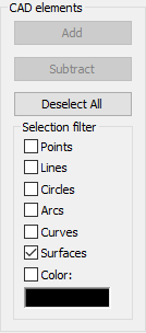

CAD Elements
The CAD Elements area modifies the level of the selected CAD elements. You can select (or deselect) CAD elements by simply clicking on or box-selecting them in the Graphic Display window. Selected elements are highlighted.
Add - Adds the selected CAD elements to the currently selected level in the list.
Subtract- Removes the selected CAD elements from the currently selected level in the list. The CAD elements are assigned the default level 0, but only if they are on the selected level. If a selected CAD element is not on the selected level, then that CAD element is not modified.
Deselect All - Clears any selected CAD elements on the Graphic Display window.
Selection Filter - The check boxes in the Selection Filter area filter the type of CAD elements assigned to a CAD level. You can also use the Color check box in this area to filter selection by the color of the CAD element. When you select the Color check-box, the color of the next CAD element that you select in the Graphic Display window is used as the filter color. For subsequent selections, you can only select CAD elements with that color.

From the Graphic Display window, select the CAD elements you want included in the CAD level. To limit which CAD element types are selectable, select the check boxes of CAD elements in the Selection Filter area.
Click the Add button. PC-DMIS assigns the selected elements to the selected level. Now when you show that level and hide other levels, PC-DMIS shows only those elements.

To add elements to the level, select the CAD elements from the Graphic Display window and click Add. PC-DMIS modifies the level accordingly.
To remove elements from the level, select the level and display its assigned CAD elements. From the Graphic Display window, select the elements to remove and click Subtract. PC-DMIS modifies the level accordingly.
