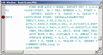

Edit window with Breakpoint (red icon)
The Edit | Breakpoints menu option provides a useful debugging tool to create, test, and run a measurement routine. Generally, measurement routines are executed sequentially, line by line. By placing a breakpoint at a particular line in the measurement routine, the execution pauses when it reaches the breakpoint. If the measurement routine makes use of variable expressions and flow control, you can examine these variables to help ensure that the measurement routine functions as desired.

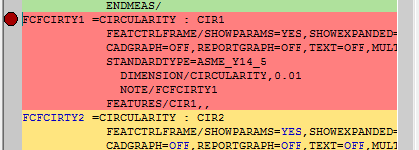

If your measurement routine uses breakpoints and the Edit window is in Command mode, PC-DMIS continues to display the Edit window during execution but highlights the current command to execute in red. If the Edit window is in Summary mode, with a breakpoint, PC-DMIS shows:
  1. Green highlight in the Edit window for already executed commands
  2. Yellow for a feature about to be measured
  3. Blue for features currently undergoing execution
  4. Orange for non-executed commands.
