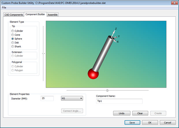

For example, to create a tip named "Tip1" from two tip element types (a Cylinder and a Sphere) you would:
Enter "Tip1" in the Component Name box.
Select Cylinder from the Tip area of the Element Type section.
Enter the diameter and height values for the cylindrical tip in the Diameter and Height boxes that appear, and then click Create.
Select Sphere in the Tip area.
Enter the diameter of the sphere in the Diameter box and click Create. The software draws each element in the dialog box's graphic area.
Custom Probe Builder Utility - Component Builder tab with a custom probe defined
Click Save to save your work.
The software indicates terminating elements in red. Terminating elements are the Sphere, Disk, and Shank tips. You cannot append other elements onto them. The example above shows a terminating Sphere tip connected to a non-terminating Cylinder tip.
The software indicates non-terminating elements in gray. Non-terminating elements are the Cylinder and Cone.
The software requires a unique name for each custom probe saved. If you want to continue to build a new component, click Clear to remove the current component.

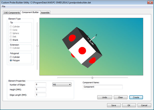

Polygons have Number of Edges, Height, and Edge Length properties.
For example, a Polygon component has these element properties:
Custom Probe Builder Utility - Component Builder tab with a Polygon created
