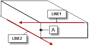

The point is created where the lines (centerlines) of the two features intersect or where a linear feature pierces a planar feature.
A - Point constructed from two lines (LINE1 and LINE2)
Constructing an intersect point from two lines

If the two features do not intersect, the point is constructed midway between the two features at the apparent intersection. In other words, the intersect point is the mid-point of the shortest line connecting the two input features.
In this example, A indicates where the intersect point is constructed between LINE1 and LINE2:
Constructing an intersect point from two lines that do not intersect
