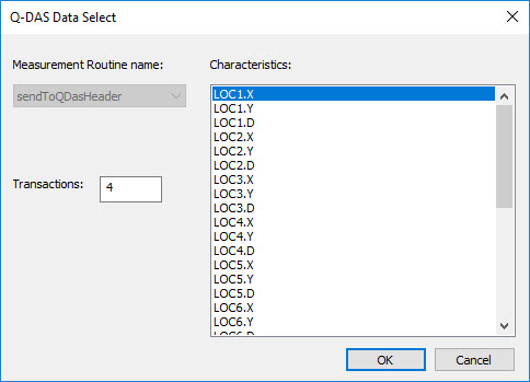

Modify the Q-DAS Chart command with the characteristic ID and the number of transactions. You can do this through a dialog box:
Press F9 on the command to open the Q-DAS Data Select dialog box.
From the dialog box, in the Transaction box, type how many transactions you want in your chart.
From the Characteristics list, choose the characteristic you want to use.
Click OK to update the command in the Edit window.

You can manually type the characteristic ID into the command's LAST= field, or you can select the command, F9, and then choose the characteristic from the Q-DAS Data Select dialog box.
Measurement Routine name - This item shows the name of the measurement routine. PC-DMIS takes this value from the header information in the Edit window. You cannot edit this here.
Characteristics - This list shows the characteristics for all dimensions that are above the current position of the cursor in the Edit window.
Transactions - This box contains the number of transactions to use in the chart. One of these transactions is the current execution. The others come from the Q-DAS database. This corresponds to the TOG3 value in the command description above.
It may take a few seconds to talk to the server and open the dialog box.
