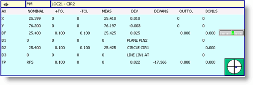

As a visual example, consider this legacy Position dimension in the Report window:
Sample Report of a Legacy Position Dimension as a Single Table

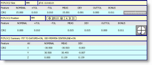

Now, contrast that with an FCF Position dimension in the Report window shown here:
Sample Report of a Position FCF Dimension Showing Multiple Tables
Notice that the FCF Position is actually contained in distinct tables that display the following information:
Size
Position
Datum Shift
Summary
All of the other FCF dimensions also use a similar reporting style. While these reporting tables differ from the style used for legacy dimensions, they provide a cleaner, easier-to-read approach to reporting dimensioning information.
