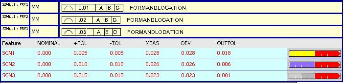

Reporting a Profile Simultaneous Evaluation
PC-DMIS handles reports of multiple scans with profile FCFs at different tolerances that are evaluated simultaneously in such a way that the tolerances for individual FCFs are shown in the report. For example, in the image below, the simultaneous evaluation of three profile FCF dimensions (PRF1, PRF2, and PRF3) appears like this:
Sample Text Report Showing Tolerances of Three Profile FCFs

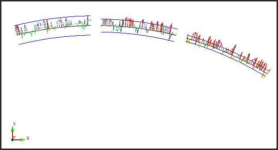

If you want to see the graphical analysis of these three profile FCFs in the report, you can create an ANALYSISVIEW command. This references the Simultaneous Evaluation command, as shown in these sample command lines:
SIMUL1 =SIMULTANEOUS/PROF1,PROF2,PROF3,,
ANALYSISVIEW/SIMUL1,,
The graphical analysis then displays in the Report window:
Sample Graphical Analysis of a Simultaneous Evaluation Command of Three Profile FCFs
